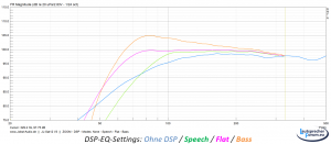

Ansonsten gäb's noch die EQ-Setups für Solobetrieb -Fullrange, Flat und Sprache.
Speech | Gain | Filter | Freq. |
EQ1 | +3,0dB | Q 2.5 | 100Hz |
EQ2 | |||
HP | But24 | 69Hz |
Flat | Gain | Filter | Freq. |
EQ1 | +8,5dB | Q 2.2 | 68Hz |
EQ2 | |||
HP | But24 | 54Hz |
Bass | Gain | Filter | Freq. | |
EQ1 | +8,5dB | Q 2.2 | 68Hz | (Flat-EQ) |
EQ2 | +8,5dB | Q 1.4 | 80Hz | |
HP | But24 | 59Hz |
