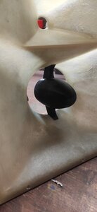

Scan:
https://www.audiofotos.eu/image/042Scan.a9IJJ
https://www.audiofotos.eu/image/042Spray.a9QAM
