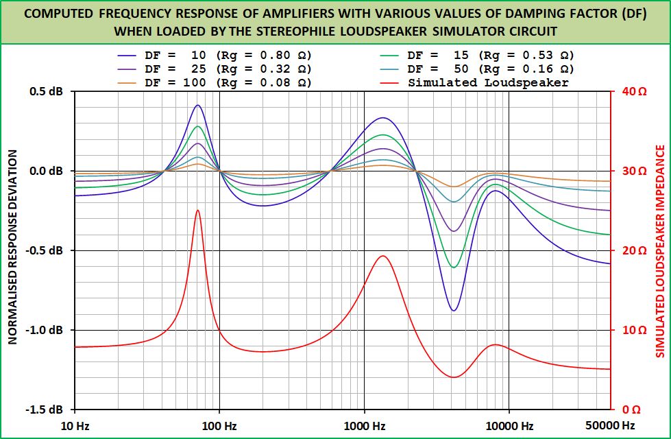

Gelöschter Nutzer hat geschrieben: 18. Jan 2025 11:10Ohne es zu wissen, glaube ich nicht das die knapp 500,-€ Endstufe einen ähnlich hohen Dämpfungsfaktor hat, wie eine M22/M22 V2/M23. .....
jeder DF über 50 ist hoch
https://us.kef.com/blogs/news/damping-f ... 0thousands.
Damping Factor (DF) is the amplifier’s ability to control speaker motion once a signal has stopped........... A high DF typically results in a tighter, more controlled bass, which is usually (but not always) more desirable from a listener’s point-of-view.....
Damping factors over ten are acceptable with numbers in the 50-100 range being a good average, but you may sometimes see numbers as high as 200 or 300 ......
Diese extrem hohen DF gehen im besten fall eh in den kabeln und weichen verloren, im schlimmsten fall bremsen sie die TT aus und versauen den klang.
Speaker Cables Set a Practical Limit on the Damping Factor
A typical set of 10-foot 12-AWG speaker cables will have a round-trip series resistance of 0.0318 Ohms. If these were driven by a zero-ohm amplifier (if such an amplifier existed), the damping factor would be 200. Benchmark offers 11-AWG cables that have a round-trip series resistance of 0.0252 Ohms. These would limit the damping factor to 317 if driven from a zero-ohm amplifier.
In other words, damping factors greater than 200-300 can rarely be achieved at the speaker terminals. If damping factors near 1000 were important, we would need to place the amplifier very close to the drivers and/or use some very large conductors. However, don't go out and buy welding cables; large conductors have inductance problems. Skip the welding cables, as this paper will show that we don't need a damping factor of 1000.
Mit DF 100 schwankt der frequenzgang ± 0.1 dB. Niemand kann sowas hören ...
Röhren mögen das nicht, deren DF ist ja einstellig, aber wenn der speaker impedanz korrigiert ist isses gut.
