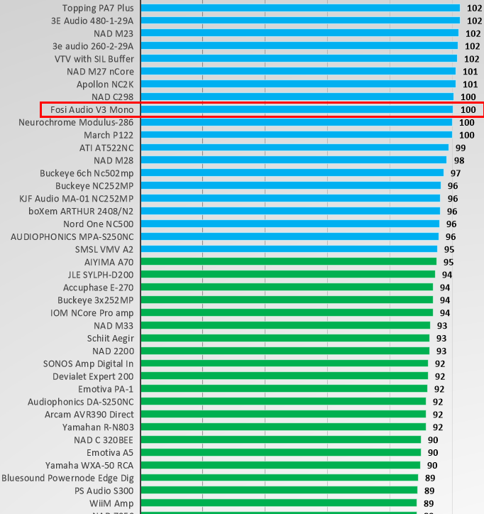

Speaker Cables Set a Practical Limit on the Damping Factor
A typical set of 10-foot 12-AWG speaker cables will have a round-trip series resistance of 0.0318 Ohms. If these were driven by a zero-ohm amplifier (if such an amplifier existed), the damping factor would be 200. Benchmark offers 11-AWG cables that have a round-trip series resistance of 0.0252 Ohms. These would limit the damping factor to 317 if driven from a zero-ohm amplifier.
In other words, damping factors greater than 200-300 can rarely be achieved at the speaker terminals. If damping factors near 1000 were important, we would need to place the amplifier very close to the drivers and/or use some very large conductors. However, don't go out and buy welding cables; large conductors have inductance problems. Skip the welding cables, as this paper will show that we don't need a damping factor of 1000.
Das thema DF wurde erfunden um die preise von völlig überteuerten class D amps zu rechtfertigen. Wenn jemand unbedingt class D haben muss, soll er zu Fosi V3 mono greifen. Bei Amir den überteuerten NAD M28 / M33 überlegen.
https://www.audiosciencereview.com/foru ... iew.53474/
Ernst_Reiter hat geschrieben: 3. Feb 2025 17:43 Das thema DF wurde erfunden um die preise von völlig überteuerten class D amps zu rechtfertigen.
Das ist natürlich falsch, denn das Thema gibt es schon viel länger als ClassD-Endstufen.
